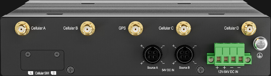

Can the two 54V DC inputs (Source A and Source B) be used to also power the device itself, or is it just for the POE?
Thank you.
Thank you.
The two inputs are via the AC adapters and are used to power the entire device, including PoE.
Thank you for your answer. Just to be clear, Iām not asking about the green block terminal connector, but about the 2 extra power connectors for POE.
Yes, they power the router and provide PoE.
Thank you @JasonHilton , @ChristopherSpitler.
