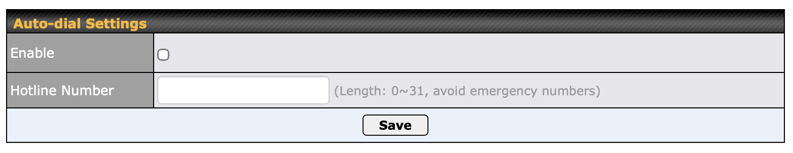

For the elevator use case there is a Auto-dial function. When enabled the POTS Adapter will call preconfigured number when goes off-hook. Though it could be helpful to know :wink:
Good to see some elevator functionality. Gives one a little more confidence that this unit actually has been tested with elevator phones. Maybe I should take a look at the manual for more details? We’re now running a Grandstream ATA, and there were a surprising number of things we had to diddle with to get it to work. Fortunately we had a retired Verizon engineer whose spoke Telephony. Our Schindler elevator phone has the phone number pre-loaded into the phone in the cab. Fun Fact: press the call button on a Schindler elevator, and the phone will NOT go back on hook until the agent on the monitoring service sends a specific DTMF code to it. Or you unplug it.

I do not think we have an function on POTS Adapter to go back on hook until the agent on the monitoring service sends a specific DTMF code to it. However, if that is something what needs to be supported, reach out to us :wink:
