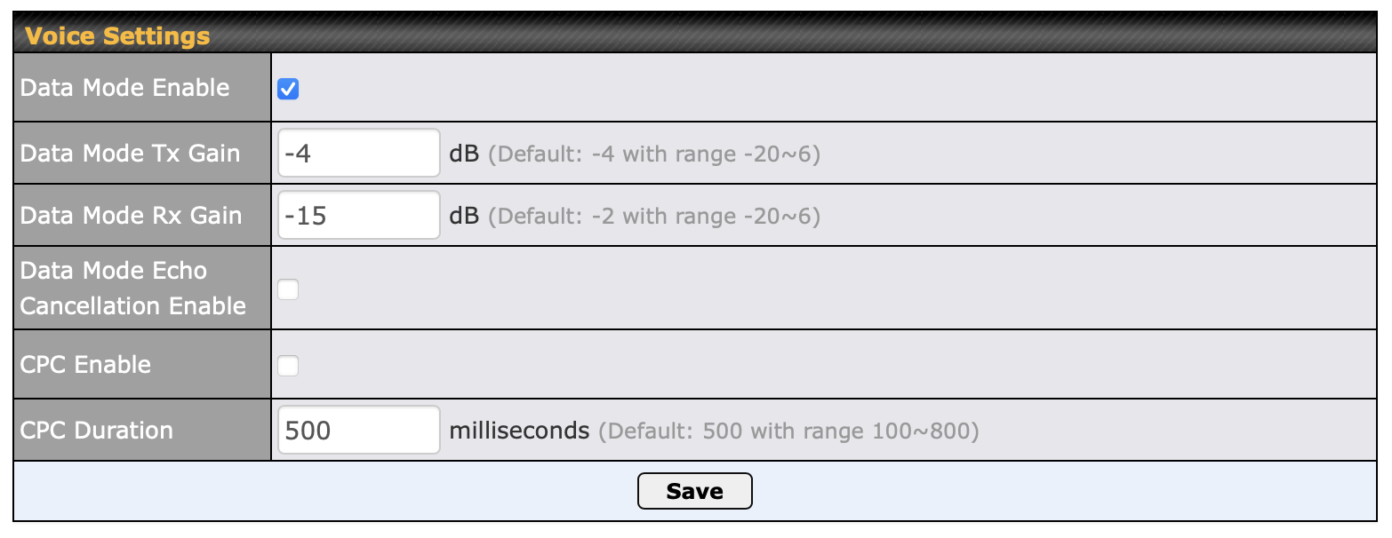

We had another client experimenting with modem we needed to adjust Data mode RX ant TX gain. After we did this it started working perfectly. Not sure if the this is the problem in your case, but could be an idea to try as well :wink:

Hi Will,
the new settings which I mentioned are available on experimental FW version. Below is a screenshot for your reference:
