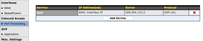

Hi, we are working on a preview version of FusionHub with Port Forward, stay tuned.
Please get the preview firmware with Port Forwarding here.
Instructions to upgrade your FusionHub.
You can configure Port Forwarding rules under Network -> Port Forwarding.

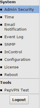

I don’t have a “Firmware” Tab on my fusion hub
I think you are using 6.2.0 build 1250.
Please download latest version of FusionHub (6.2.1 build 1289) and follow the “FusionHub 6.2.0 Upgrade Guide” in the binary package to upgrade your FusionHub to 6.2.1.
If you just want to beta test the Port Fordwarding feature, I suggest you setup a new FusionHub (6.2.1) instead of upgrade the existing one (6.2.0).
Then upgrade it to the preview firmware from “System -> Firmware”
Did anyone succeed with port forwarding?
I’m trying to use the port 162 for SNMP on a client and forward this port via the fusionhub. As server IP I have put the address assigned by the DHCP due to the NATed speedfusion configuration
Target is to have one port per client to reach them all via snmp.

So essentially then you will create the port forward in FusionHub to forward the necessary ports across the SF tunnel to the private ip of the server behind the BR1.

BR1’s snmp server only listen on LAN and WAN IP addresses but not the address assigned by PepVPN.
If you want to forward snmp from FH to BR1, you need to un-check NAT-Mode in PepVPN profile, modify FH’s port forwarding Server from 169.254.131.2 to BR1’s LAN IP address.
