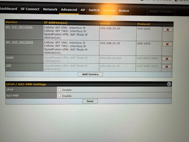

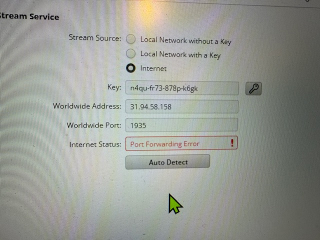

Thanks for your help, this is what I’ve done on the peplink. The device I’m using (a Blackmagic streaming decoder will actually auto search any port that’s open and give you the option to use that, the manufacture suggests 1935, so that’s what I’ve gone with. Once those details are in the “Port forwarding error” changes too “Visable worldwide”

That’s a weird setup - normally you would set up port forwarding on a single public IP address - you seem to have it set up on three different IP addresses. I’m not sure how that would work.

  • set up port forwarding on a single IP address and test that out first.
  • you should hide your actual IP address and Key for security reasons. You posted this in the 2nd picture.
Thanks for your message, the address in the second image isn’t a worry as my Peplink doesn’t have a static IP so that IP address has gone now.
Should i only port forward the Speedfusion connection and ignore the others (in other words it would only work when bonding?) i have two lists as it requires TCP and UDP
  • I would start simple, testing out a single interface at a time, but ultimately if you are using SpeedFusion, that should be the only one you need to use, as it will automatically use whatever WAN interfaces have connectivity.
  • I suspect the message “Visible Worldwide” is not an error message, rather it’s telling you that everything is working, and your IP + Port Forwarding is working properly, and can be accessed anywhere in the world (“Worldwide”).
That’s correct, I have tried just the speed fusion connection and i still get " Port forwarding error" on the blackmagic unit. Is there a way i can check if traffic is going through or not?
