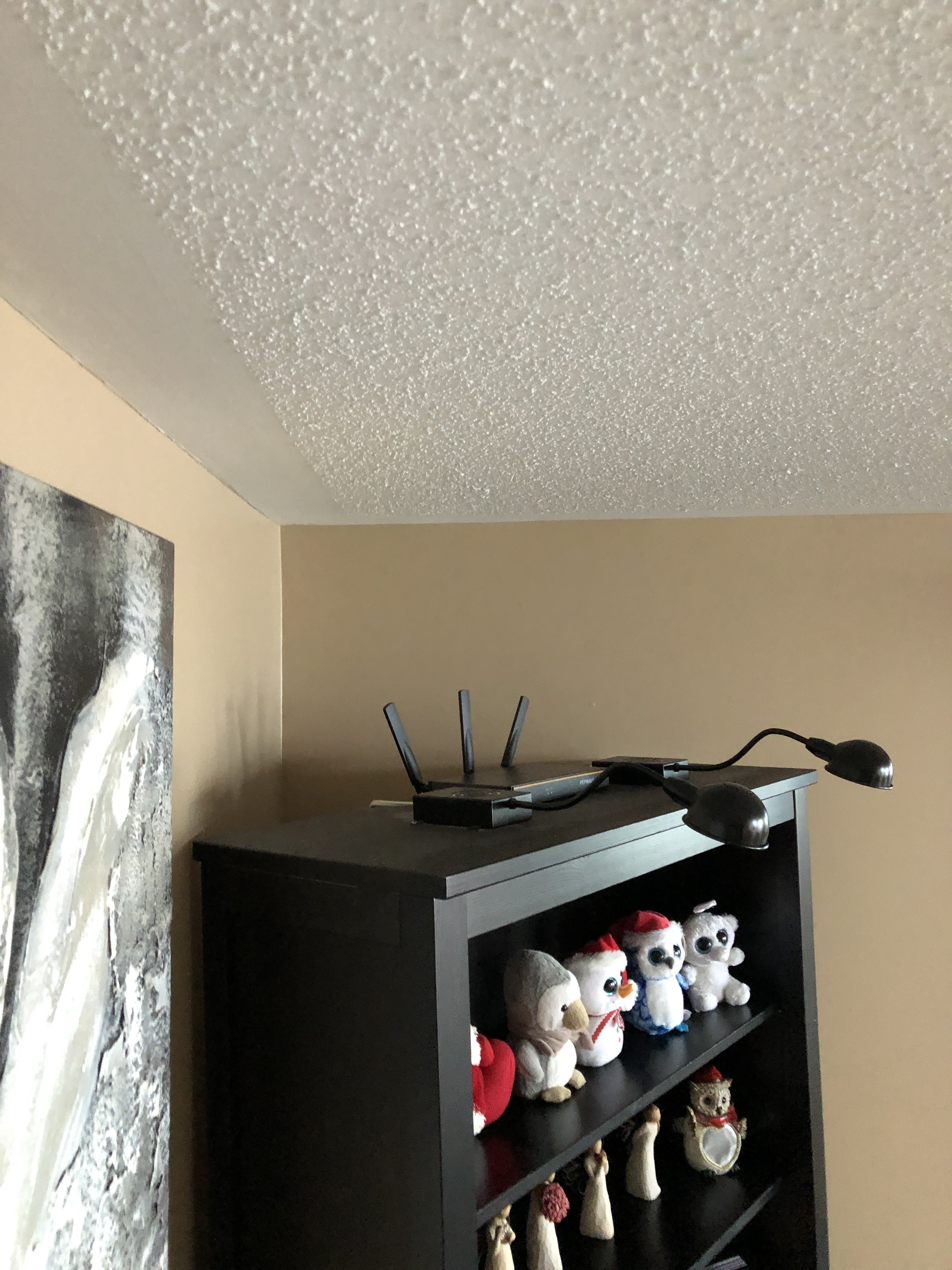

Placement is important!
image|375x500
Where it is now on the main floor is tucked in a corner at a 45 degree angle to the floor layout close to the ceiling. I also have a metal bathtub almost directly above it.
I may try moving it away from the corner. Considered perhaps placing on 2nd floor but will have to test whether range is adequate to the basement.
Noted. Just for “grins”: Try moving those two lights a bit farther away from the router (or unplug them as a test), particularly if the power supplies are contained therein. If these are LED lights they likely have switching power supplies which are often wide-band noise generators and that noise (including harmonics) can extend up into the 2.4GHz spectrum.
They are halogen and are plugged into a switched outlet. I didn’t see any noticeable difference in signal strength with them turned off, on and unplugged. My iPhone signal strength was pretty constant -70-72 using router utility iOS app.
