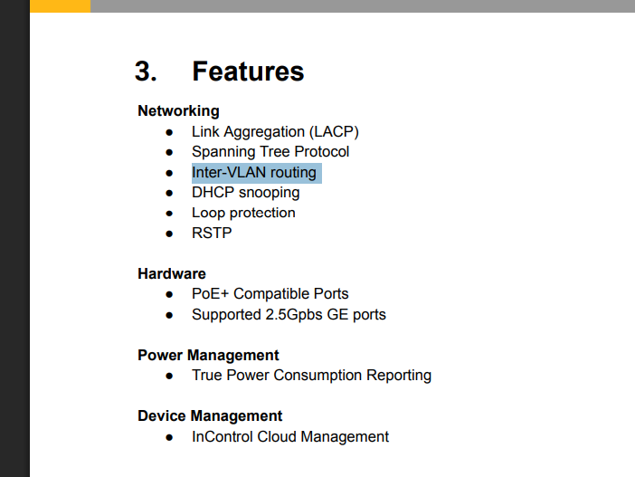

But the series manual clearly states inter-VLAN routing as a feature. Could it be a mistake?
Please share where you’re reading this from.
I suppose you are referring to these :
This is added by mistake. Thank you for raise this up.
