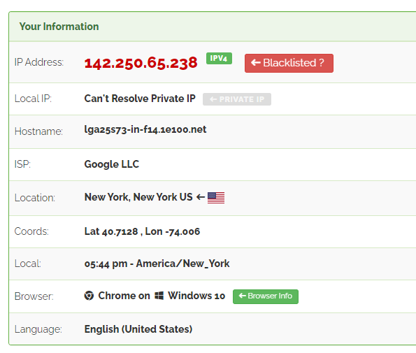

Enabling that DNS Forwarding Setup did seem to get rid of the google DNS queries though. Previously, looking at logs, the Services would list Google and DNS (on 443? and 53) for the dest IP of 8.8.8.8 - Now, enabling DNS forwarding setup, there does not appear to be any DNS service listed in the logs, and Google service is being sent to lga25s73-in-f14.1e100.net (whatever that is - apparently also google-related somehow!)
