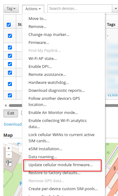

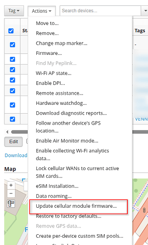

Hey, If you go to the device management page or click edit on the dashboard, in the actions menu you got this
That`s only the new Firmware Check.
