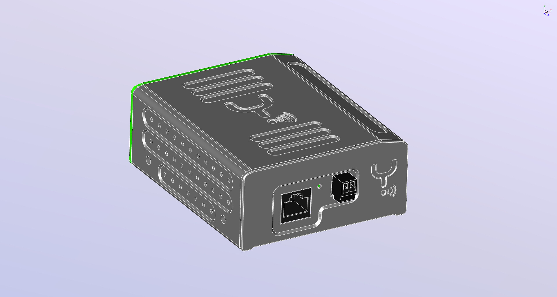

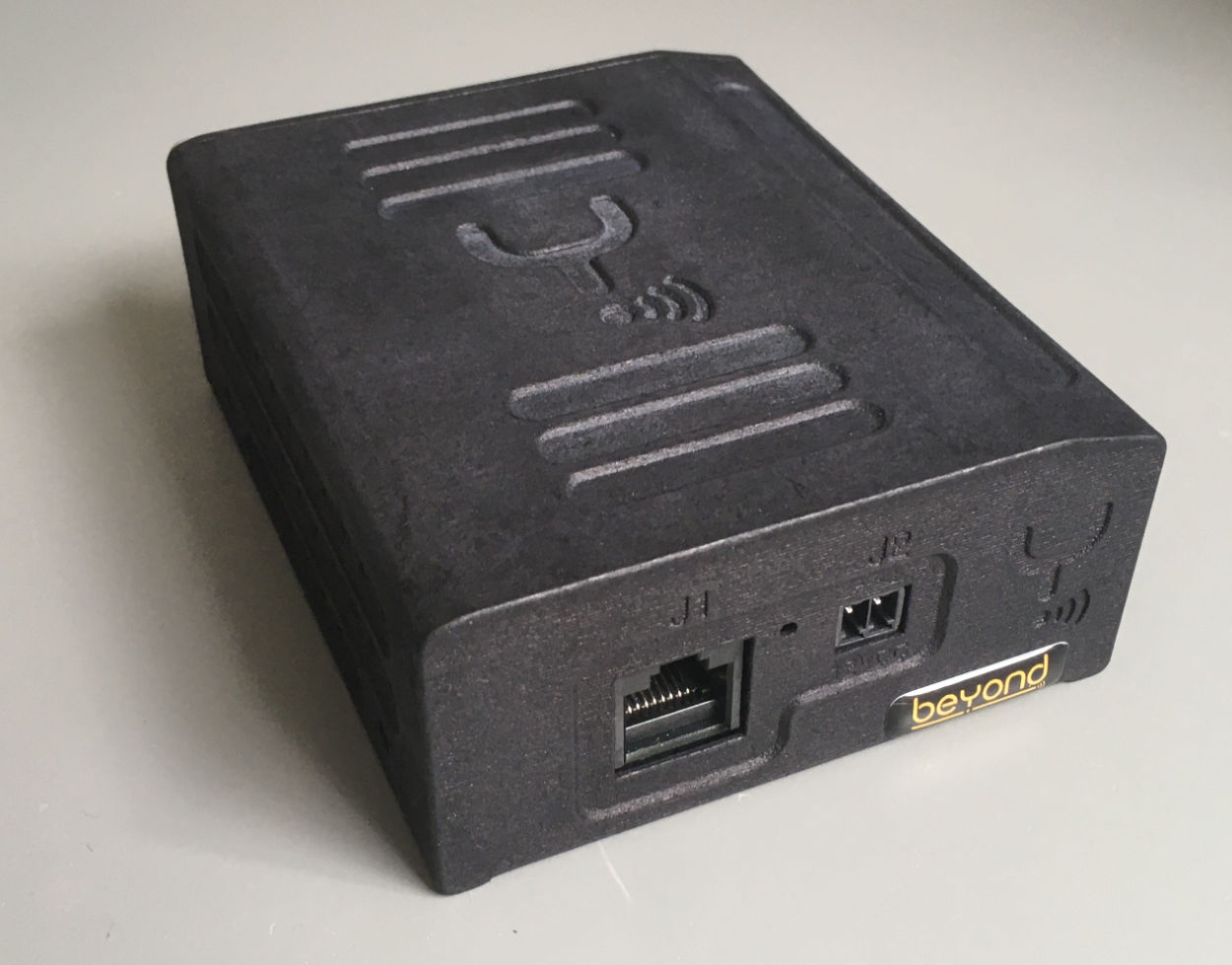

I would like to share two Pepwave units modified for specific use on Drones and Unmanned Systems.
beyAIR-SOLO (MAX BR1-Mini)
beyAIR-DUO (SpeedFusion Engine)
Our goal was to lower the units weight as much as possible. On the beyAIR-SOLO we cutted down 100g, on the beyAIR-DUO 150g.

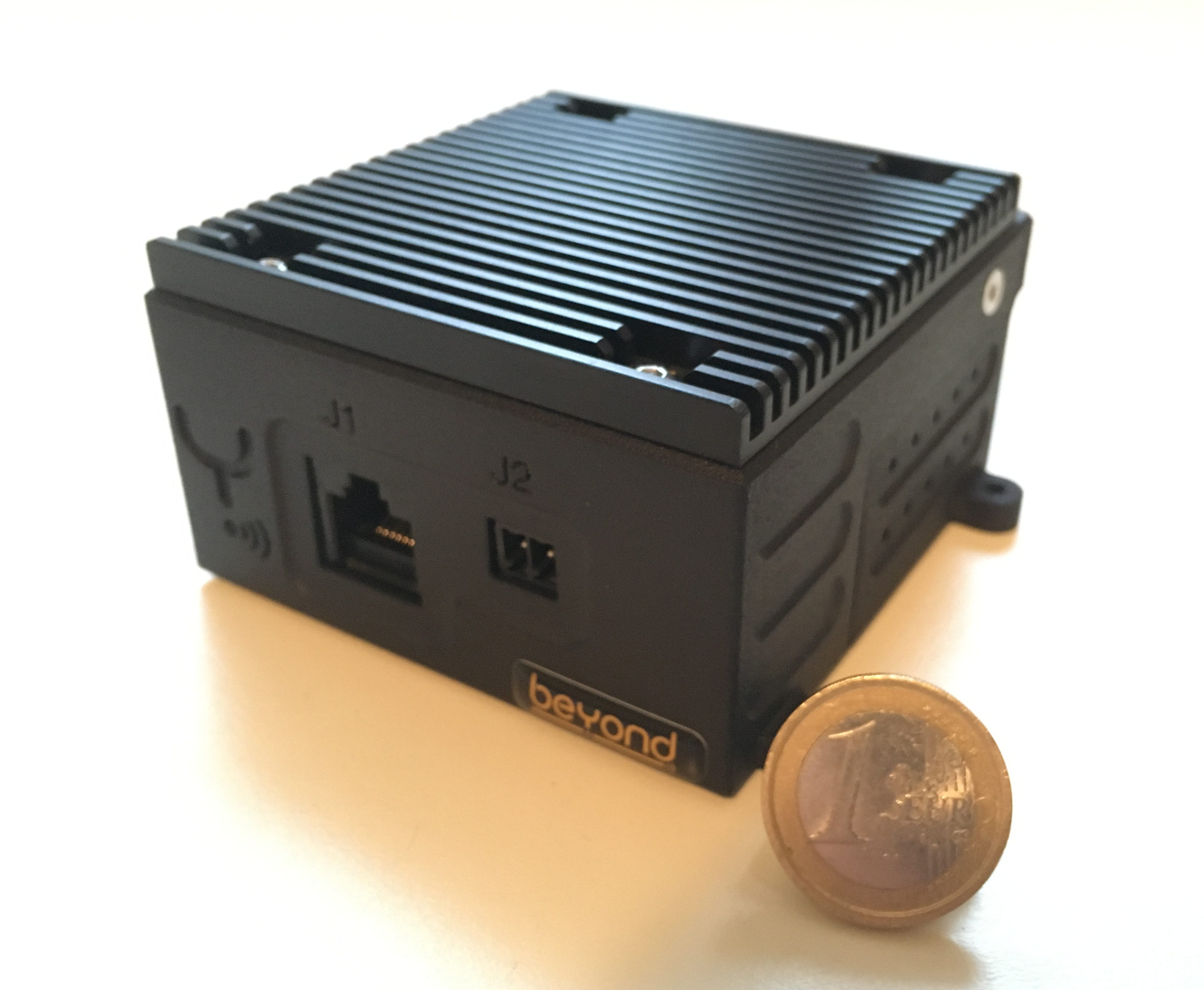

Second round! The beyAIR-DUO on the SFE basis. However weight of about 200g instead of 350g and standard SMA connectors.
New beyAIR-DUOv2. Same size as SFE bit 256g only. Can be 195g if heatsink will be changed with the fan.
This is a very nice one. Actually you could post this on SpeedFusion.com so other community members that might need a lighter enclosure can go with this carbon fiber enclosure. You might not need the heatsink when it’s installed on a Drone. We put a heatsink there just for the device to work under a concealed environment.

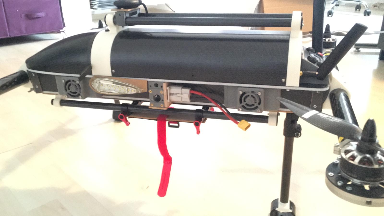

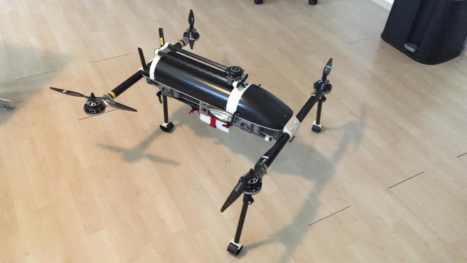

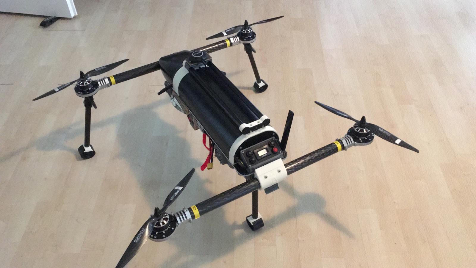

The issue is that antennas should be outside the drone frame and respect the MIMO rules (90° and minimum distance requirement) for best performance. Also there are a variety of antennas for a variety of applications. However your mind was totally correct :slight_smile:
We made a R&D Test drone to test all possible configurations.
