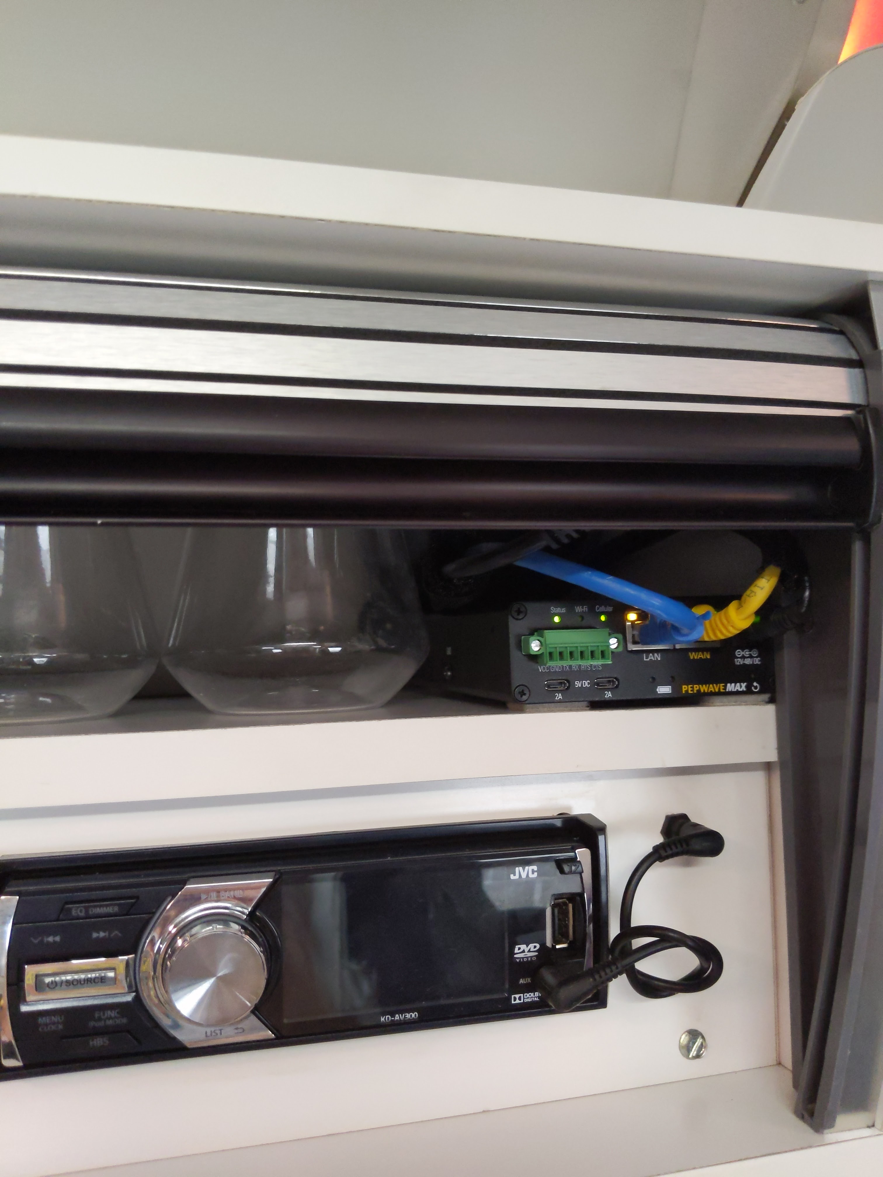

To follow up, I’ve moved on from this strategy. I picked up a CAT 18 Pepwave MAX Transit, and wired up all the antennas to it. It’s above the radio in the cabinet.
Next I picked up a AP One Rugged, and installed it on the side of the cabinet.
I’ll use the MK3 for hotel / car trips instead.
I went from one bar on my Netgear Nighthawk to 4 bars of LTE in the same spot. That was the biggest change and a win all around.
