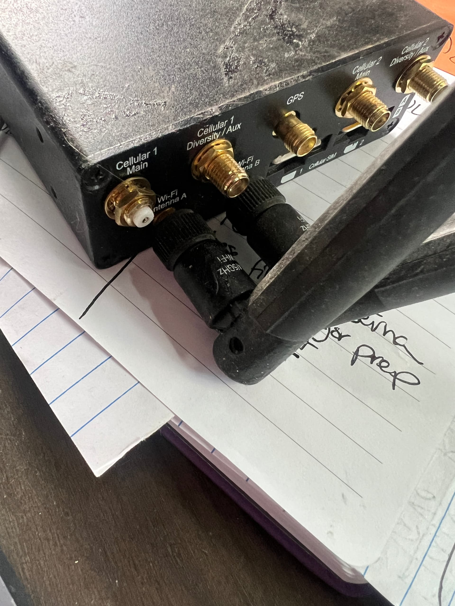

Hello Community,
My gold thereads on my cell 1 broke off when screwing in and im past my warranty i believe ive owned it 4 years.
It just needs a new gold screw thingy for the incoming antenna but this is the most important port.
I cant sem to find the part # or procedure online. Thanks

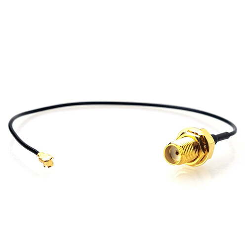

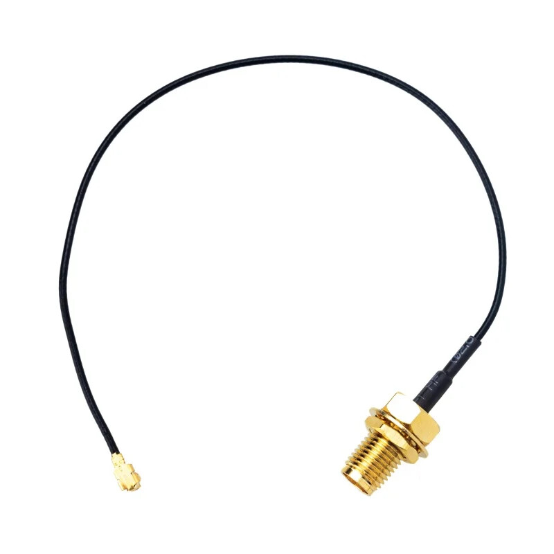

The damaged SMA is part of a cable assembly that connects to the cellular module. You can buy a replacement cable assembly. You need an SMA Female bulkhead connector at this end and very likely a ufl connector at the other end.
The only other thing to find out is what length this patch lead needs to be.
Something like this:

I bought this then the simple metal that screws the antenna broke when i unscrewed it and i called pepwave probably a year and half after purchase and they said they were not responsible for this main 1 terminal breaking so i want to just fix it and move on with my life and need the part.
I could get it to a pro in phoenix and pay more money but only if i have to pay for their poor material and fix it? its just the metal female bad part they sold me with a 1,000 router…
