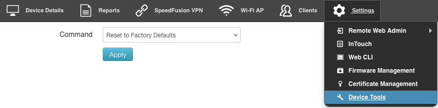

Hi! Yes you can also factory reset the device via InControl2 or the Web Admin interface.

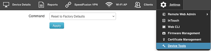

From InControl2:
(Device Level) > Settings > Device Tools > Reset to Factory Defaults

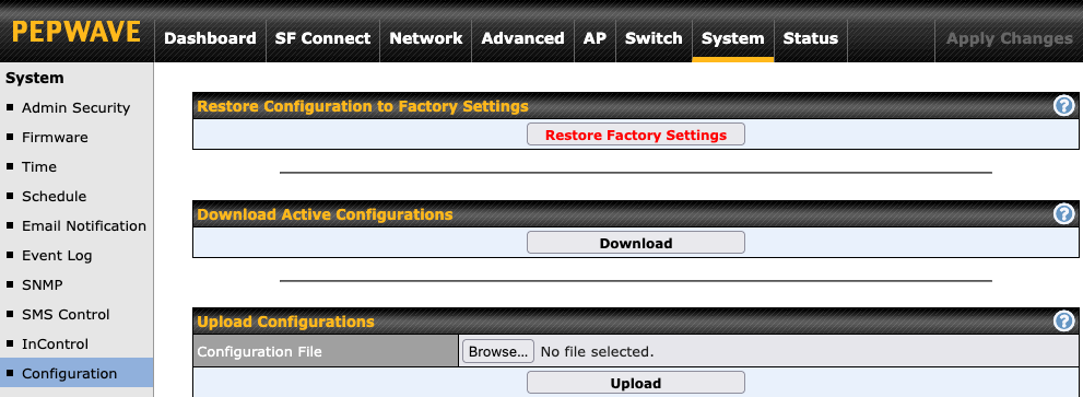

From Web Admin:
System > Configuration > Restore Factory Settings
