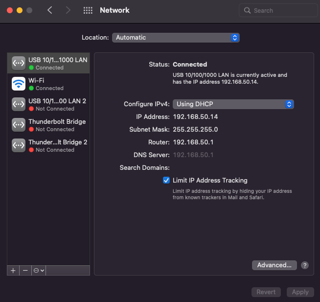

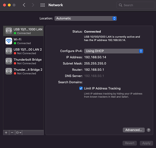

After the Status LED goes back to green, I was able to see the Router was on 192.168.50.1, but still cannot reach the UI login page. It has been attempted on multiple computers.

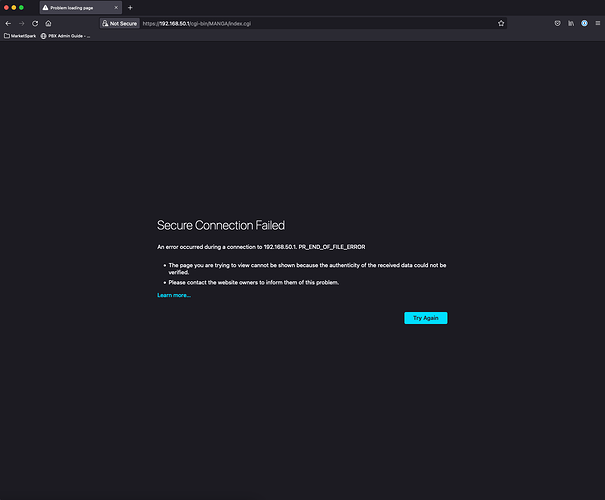

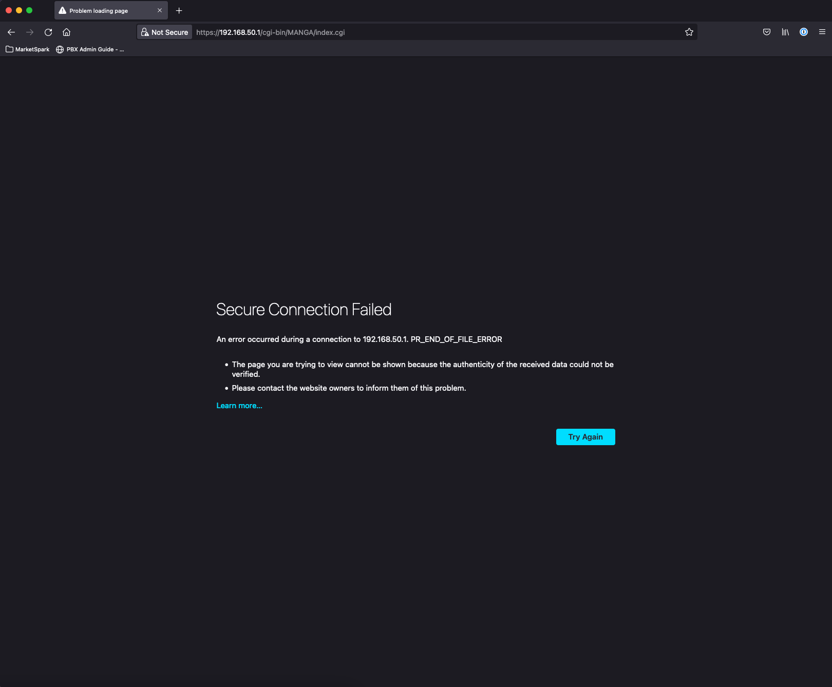

Have you tried https://192.168.50.1 ? Maybe its using SSL?
Here is how my browser responds above.
My laptop is recognizing the device on 192.168.50.1
