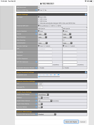

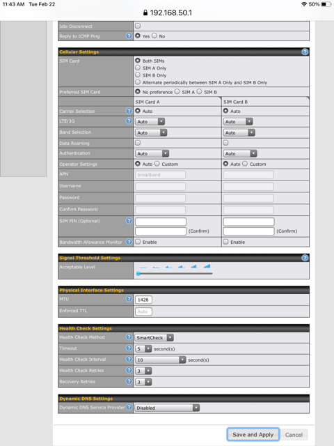

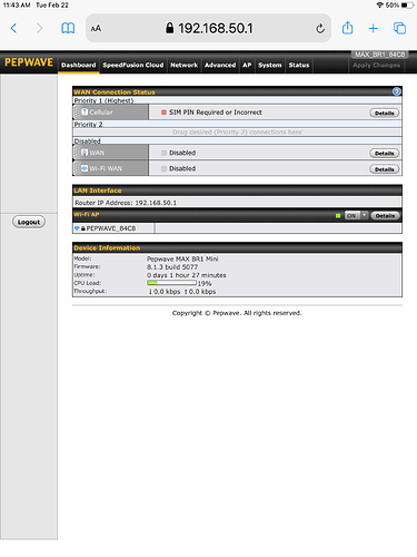

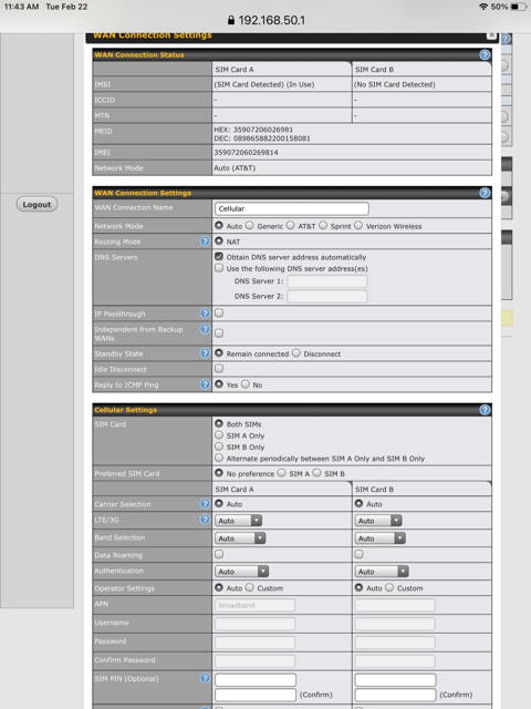

Hi Support, we have a Pepwave Max BR1 Mini router and an ATT SIM card. We have validated that our router is compatible with ATT. We are also on the latest firmware 8.1.3. We receive the message “SIM PIN required or is incorrect” when we insert the SIM. We’ve tried 3 diff SIM cards thinking the SIM may be bad but we get the same error message for each. We’ve reset the router to factory settings multiple times. When we do that, the SIM shows “connecting” and then 30 secs later, we get the message “SIM PIN required or is incorrect”. We’ve tried slot A and B. We’ve spent hours Googling and have had zero success. The router is not usable at this point.
@Nicole_Woodward, please try 8.2.0RC. If the problem persists with 8.2.0, please open ticket for us to check.

That firmware update fixed the problem! Thank you!
