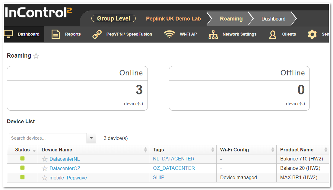

Select the Peplink router or Fusionhub that functions as the hub in a datacenter.
Select the device details and click on “edit”.
Create a unique tag (Oz_DATACENTER is used as a tag in this example).
Create another tag for devices that will be used as the endpoint for this connection; in this example, we created a tag “ship” and added it to the unit that is installed on our ship.
