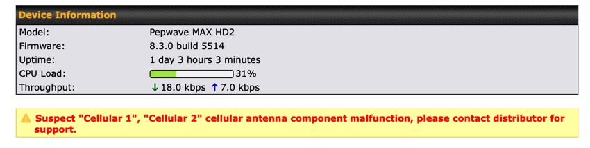

Hi there,
on the Peplink MaxHD we now got a message saying <Suspect “cellulalr1” cellular antenna component malfunction , please contact distributor for support.
Any suggestions on what it could be and troubleshooting option to consider?

Image 15-03-23 at 12.42.jpg|850x214

Are you using an antenna on both the Main and Diversity?
I’m seeing the message on every Max HD2 where I don’t use an antenna on the Diversity. Where I have both Main and Diversity connected there’s no message.
It would be nice if the message indicated Main or Diversity and gave a config option to ignore the error on the Diversity side.
In my case the antennas are two directed MobileMark panel antennas, with two antennas per unit. All hooked up.
Diversity?
Each mobile interface has two antenna connectors. A Main which is TX/RX and a Diversity which is RX only. So in the case of the MAX HD2 Mini’s, there are 4 mobile antenna connections in total.
I see the message you posted in the UI when I don’t have an antenna on the Diversity connector on any of my MAX HD2 Mini’s. When I do, the warning message isn’t displayed.

@Pierre_Dtm @timsee ,
You can create a ticket to allow support team to check on the device.
The warning message is not a bug but a helpful detection method to help our user to detect the antenna connection issue prior to really needing to attempt the devices for any problem related to the Cellular WAN connection issue. The detection method will compare the signal different between the antennas and display the warning.
What you need to do when you see the warning message :
  1. Please check and make sure all the antennas are properly connected to the device.
  2. Initiate a reboot for the device after you have confirmed the antennas are connected.
  3. Upon the device is startup up , please recheck the Webadmin dashboard and check whether the warning message is still shown.
  4. If the message still shown in the dashboard, please open a ticket with Peplink support team to check.
  • It’s ok for you to open a ticket with Peplink support team to double confirm the issue even hardware warranty is expired for the device. Peplink support team is always happy to help with any issue that user are seeing.
