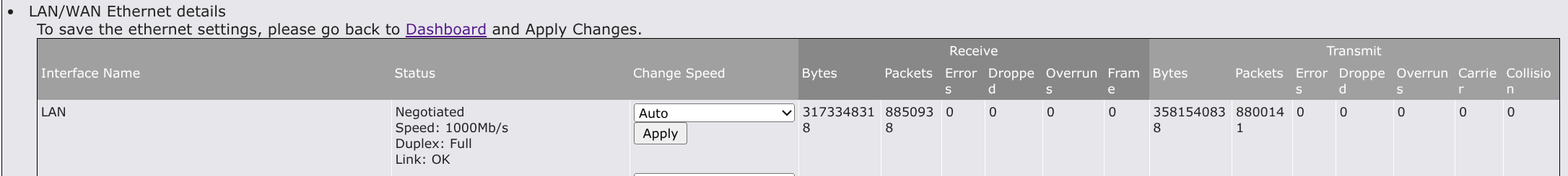

Hi…
Are you getting some erros at eth port?
Checking using the support page…
After login at you device… change the url
(SAMPLE)
from
" https://x.x.x.x/cgi-bin/MANGA/index.cgi?mode=config&option=main "
to
" https://x.x.x.x/cgi-bin/MANGA/support.cgi "
and check the eth port (LAN/WAN) statistics.

@MarceloBarros No errors on WAN interface.

I did see a few WAN receive packet loss, but not very much
