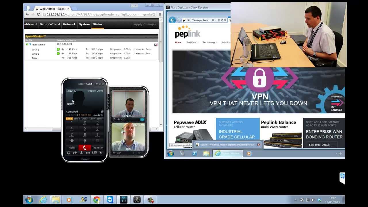

The technology is called speedfusion VPN - its quite a big deal. Best start on the technology page here; https://www.peplink.com/technology/speedfusion-bonding-technology/
Demos:
I strongly suggest you speak with a Peplink Partner in your region. Most are very friendly - promise, and they will be able to help you pick the right products and configure the VPN in the best way possible.
