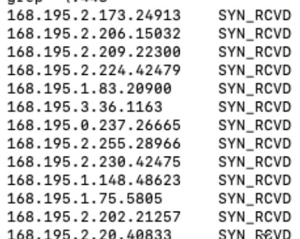

I am running several servers which were having weird performance problems. I was finally able to debug the problem by running this command on macOS:
netstat -anp tcp | grep '\.443 '
which showed hundreds of tcp4 connections stuck in the “SYN_RCVD” state:
These happen to be Brazilian IP addresses, and we have no customers outside the USA.
Clear evidence of a SYN FLOOD attack.

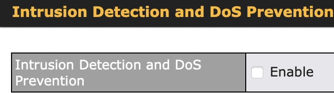

I checked the Peplink UI and found this:
So I enabled it, and applied changes.
The UI states:

However, it had absolutely zero effect.
Does this feature work at all? I could not see any evidence it does anything.
