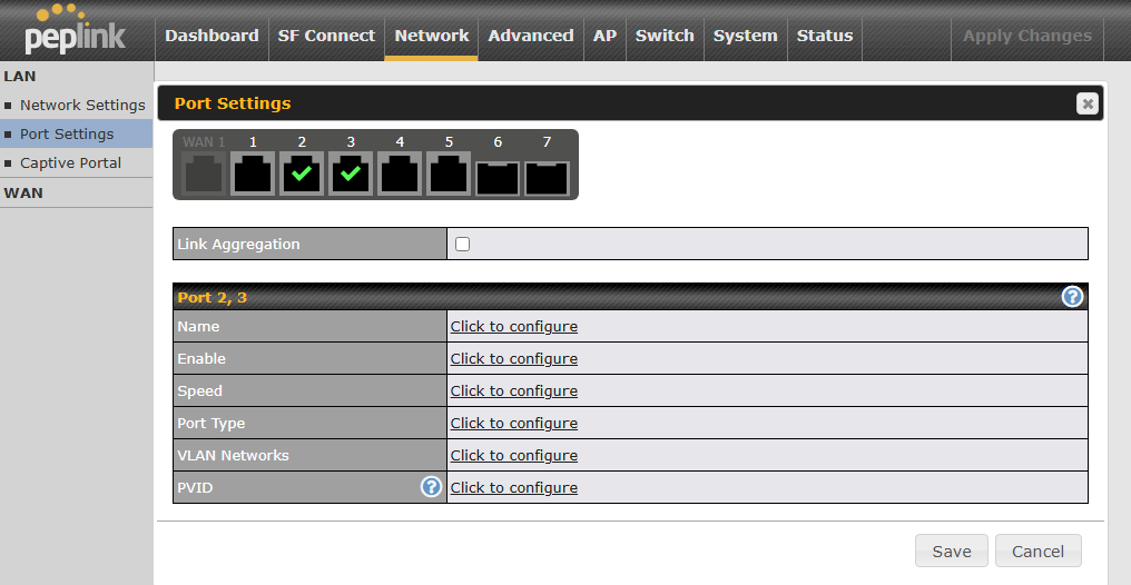

normally you go to the interface page, select both interfaces then it offers you link aggregation:
Hi Bryn,
Yes but it wont show up i’ll log a ticket with peplink see whats happening.
On some of the newer HW2 units the LACP option doesn’t show up in the interface even though the datasheet lists it. A bunch of people have noticed this.
Thanks for reporting to us, this is noted and notified in a support ticket too.
The feature is currently targeted at firmware 8.6.0. We will share an update if we can make it available earlier. :wink:
