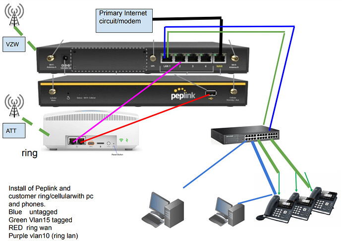

We set it up so that the Ring alarm pro wan is on LAN2 of the pepwave on a seperate vlan.
This vlan has an enforced outbound policy that only allow the Ring alarm Pro to utilize the wired wan of the pepwave.
This allows us to then connect a lan side of the Ring alarm pro , back into the pepwave on the usb wan interface.
This allows us to use the Spectrum wired wan internet, the ring alarm pro built-in cellular and the cellular of the 20x.
Another reason that we connect it in the manor is then the ring alarm pro will still be able to have a primary wan interface via the spectrum to save
on cellular unless it truely goes out.
I currently have the built-in cellular on p3 of the speedfusion tunnels, as I’m not sure how quickly the ring alarm pro will switch over to cellular and since it’s built-in to the device , I can’t tell if I’m using spectrum, or cellular, until the primary wired wan goes down.
Here is a diagram of the deployment.
