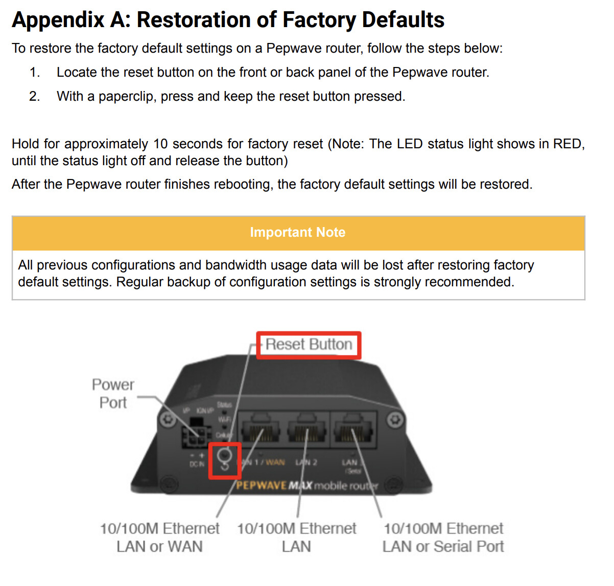

Please see the user manual (https://download.peplink.com/manual/pepwave-max-user-manual-8.4.0.pdf), Appendix A:
As a note, if the device is claimed to InControl2, depending on the IC2 settings, the device may have a policy immediately re-applied to it that may set the password.

Hi @nyishin16 . The procedure Peplink has documented and which @ChristopherSpitler pointed you to did not work? If done correctly vis-a-vis timing the log-in credentials should be restored to those shown on the bottom of the device. If you hold the reset switch down too long you will do a factory reset. We have not had to do this a lot but have not seen it fail.

I understand that the ability to reset the admin password only using the reset button was removed sometime before firmware 8.4.0; the only options now are a full factory reset of the device or pushing of a new password via an active Peplink InControl2 service.
The ability to reset only the router’s admin password was removed to comply with industry security requirements; our team fully supported the removal of that reset feature (and was one of the teams to request its removal: Disable Factory Reset Button - #11 by mldowling ).
