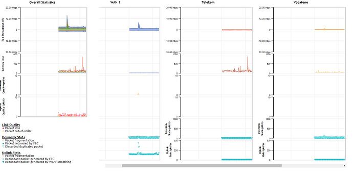

after discussing some topics with Dennis Hofheinz on the tele (thanks for this) - I still have massive issues with our Balance 310 5G router and packet loss on the SFC side.
All single WANs are nearly perfect but on the SFC side I’m getting a constant packet loss amount of 10pkt/s. That is not acceptable and I have no idea what I could do to get rid of it.
I had this with SF on a VULTR machine. On AWS it was somewhat better. Today I bought a SFC packet and tried that because imho this should be the best option because it is hosted by Peplink. But even with SFC I don’t get any better connection - Packet loss constantly - even at a 4MBit video stream.
I even tried to switch from DP to TCP (Dennis suggested this) but that makes no difference at all. Still constant lost packets.
These are the settings:
Dynamic weighted Bonding
WAN Smoothing:
Overall Redundancy Level: Normal
Maximum Level on the Same Link: Normal
With these settings I get the result that is documented in the screenshot.
What I discovered:
If I switch off WAN Smoothing and activate FEC (high) instead, the packet loss vanishes. There seems to be an issue with the WAN Smoothing feature here.
Anyone with a solution to this?
Thanks and cheers

OK - now it’s getting really weird:
I setup a SF endpoint on AWS and monitored the remote WAN there. On the SF side there are no packet loss events detected. If I look at the local interface of my Peplink 310 5G there are lot of packets lost to SF.
first the screenshot of my Peplink device:
And here is the screenshot of the SF client on AWS at the same time:
I would really like to know what is going on here…
