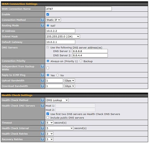

@Xerxes Can you confirm that a Health Check is configured on the wan in question?
If no health check is set then there would be no failover when traffic is not passing.

Health checks are configured on all three WANs. Using DNS lookup. However this has me confused on how this works. From which connection is it doing the lookup? During the last outage, it showed a WAN as red with failed DNS lookup, so connections should have failed over, but didn’t.

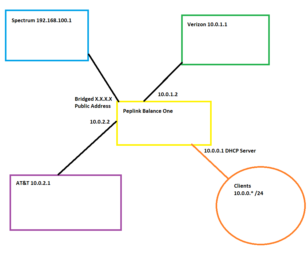

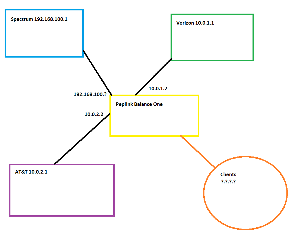

The Balance One is is acting as the switch for all 3 connections (Balance 30 LTE - cellular, Balance One - ethernet, Nighthawk - cellular). WAN 1/2/3 is using DNS Servers 8.8.8.8, 4.4.4.4. If the BalanceOne is doing the DNS health check for WAN2, which is on the Balance 30 LTE, the Balance One may have an internet connection, so maybe that’s part of the problem? Unless it’s querying the DNS servers from the IP address assigned as a client on the WAN itself?
I just want to verify that the Balance One is currently acting as the central router on the network, NAT routing clients from address range ?.?.?.? to the 10.0.1.1, 10.0.2.1 and 192.168.100.1 respectively.
To answer your DNS query question, the queries would come from 10.0.1.2, 10.0.2.2, and 192.168.100.?
This is almost spot on. The Spectrum modem is in bridge mode, so the Balance One is 10.0.0.1 and is responsible for DHCP on the network and hands out 10.0.0.* addresses to all clients. The Balance One then figures out which route to send the clients to.
Cool. Maybe @erickufrin and @Rick-DC have some other things to check, but as long as all those 10.0.X.X address ranges are /24 (255.255.255.0), then when a particular WAN is Red / marked down on the dashboard it should failover to the next connection. Those last 2 rules in your policy both make things use whichever connection has the lowest latency, but since they are at the bottom, they would only be used as a last resort and still wouldn’t cause traffic to route to a Down/Red WAN connection. Here’s the updated diagram.

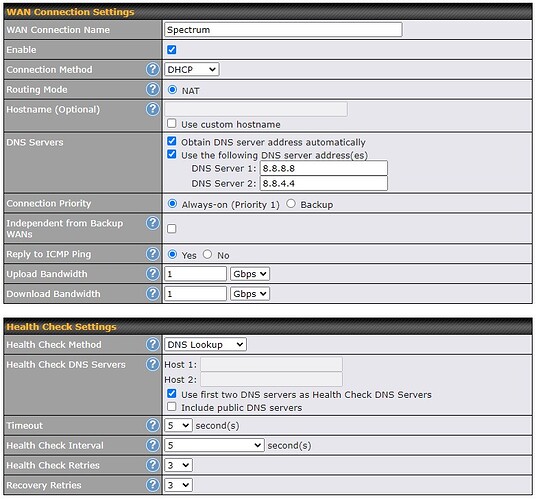

Here are the health checks:

I would also uncheck “obtain dns server address automatically” on the spectrum.

I will uncheck the auto DNS checkbox on the Spectrum.
