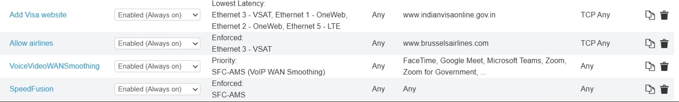

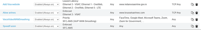

Thanks a lot for your response, yes attached is the config; the bottom two are through the speed fusion, the others are websites that I am trying to fix and I believe this config should route the traffic directly through the WAN paths
I had this identically configured but added additional WAN paths in case the one of the WAN paths was not available when the attempts are being made. I have had no complaints regarding the airlines website though
Please let me know if you need any other information?
Try removing the www
As Jason mentioned remove the “www” from there so the domain is treated as a wildcard.
I’d also set the protocol to “any” for now too, just in case either of those sites are using QUIC protocol.
Thanks both! it is working now!

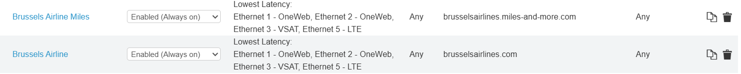

Sorry about the follow up on this post, the main website is working for https://www.brusselsairlines.com/ but when they click on the login section the login page is getting blocked! I have added both the links as per the attached but the main site is working but not when they click login, is there something else that needs to be done as a wildcard to allow subsequent browsing
Any advise on this please?
As before, you are possibly being too specific or the sites are loading resources from other sources that are not tied to the top level URL.
Try doing “miles-and-more.com” on its own without the specific sub domain.
A way to normally look into these loading issues is often to use developer tools in your browser and see what sources are being used to load content from and whether they need to be bypassed.
If you keep running into these kinds of issues then considering who or where SpeedFusion service is provided from for you might need some consideration.
Many of the public cloud providers (including the ones that Peplink themselves use) IP blocks will be flagged as “VPN” or some such so investigating whether there is another provider, or location you could host your own FusionHub at is a viable option.
