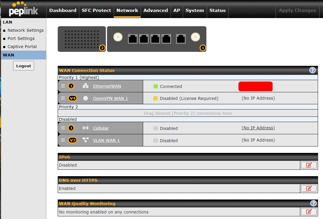

After installing the license manually and rebooting a new WAN shows up: OpenVPN WAN 1
I configure it and enable it but nothing works.
The OpenVPN WAN remains disabled. It complains that a license is required and there is no IP address.

WAN: OpenVPN WAN 1 changes applied
After some fiddling, I now see this in the Event Log:
WAN: OpenVPN WAN 1 (Priority 1) disconnected (License Required)

Update: I tried a third VPN Provider, Windscribe. Same thing, the WAN is still disabled because a License is needed. Clearly not a VPN config issue.
