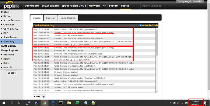

Do you mean this NTP server - 0.peplink.pool.ntp.org? My device is syncing with it without issue. I suspect it is the communication issue (WAN connection issue or the IP failed to resolve) between your Balance One Core and 0.peplink.pool.ntp.org. Please try to ping 0.peplink.pool.ntp.org from System > Ping when the problem occurs.

The time synchronization is written into the event log once only for each boot. Fyi, the time synchronization will happen every 30 minutes based on the startup time.
Please open a ticket and attention to me if you wish to find out the root cause.
