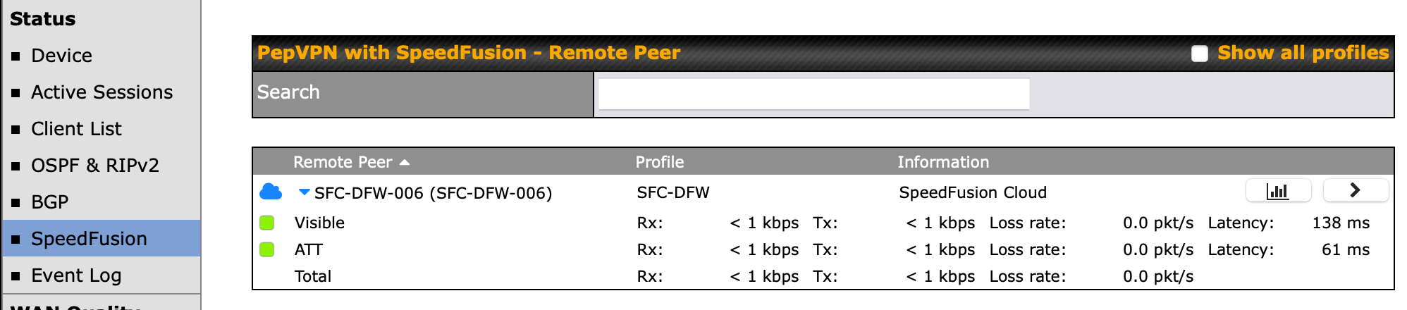

I tried that with no luck. I disconnected the two devices to see if they could run speedfusion separately and the balance was able too bond the two cellular connections with no problem
image|690x152
The cat 18 on the other hand will still not bond on the cellular connection. Any thoughts?

I have run more test and isolated the issue to the SIM slot on the transit being active. If I disable the sim on the transit the WAN connection on the balance shows active.
Balance:
Transit:
If I move the cellular (sim) back to active i get this result:
It’s only when I have Speedfusion running on the balance 20x with the WAN connection included in the bonding and the cellular connection active on the transit cat 18 that there is any problem.
