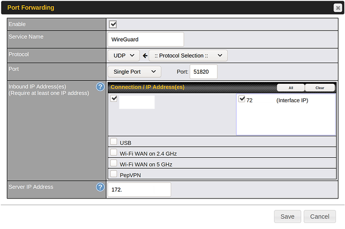

@MartinLangmaid The surf soho is the gateway router in my home. I attempted to set up port forwarding, but I am unable to connect to my VPN. Here is what I think I know: The dyndns is setup correctly, because I just witnessed my IP address change in the dyndns control panel. The wireguard credentials appear to be okay. What I’m not sure about: my inbound firewall rule is the default option, but it is set to reject all. I tried accepting all (the default setting) and I also tried a rule to allow the wireguard port, but no luck. The only thing I can guess right now is my port forwarding setup isn’t correct.

for testing leave that as accept all. eg:
Nothing wrong with that at first glance,

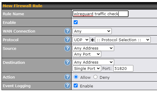

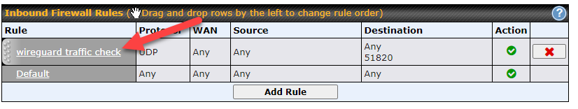

Create a new inbound firewall rule for the destination port set to accept and enable event logging and put it above the default any:any allow rule:
When traffic hits that port you should see log entries on the status log page - do you?

THANK YOU!! I can see that I’m connecting to my vpn but there is no internet access, and it seems to be a dns issue on the wireguard device. The wireguard traffic check rule allowed me to connect, and I was able to set the default rule back to deny afterwards. I’m going to keep plugging away and see if I can find out where I’m going wrong with the wireguard device.
If the default rule is deny, then responses to outbound traffic from the wireguard device will get blocked…
