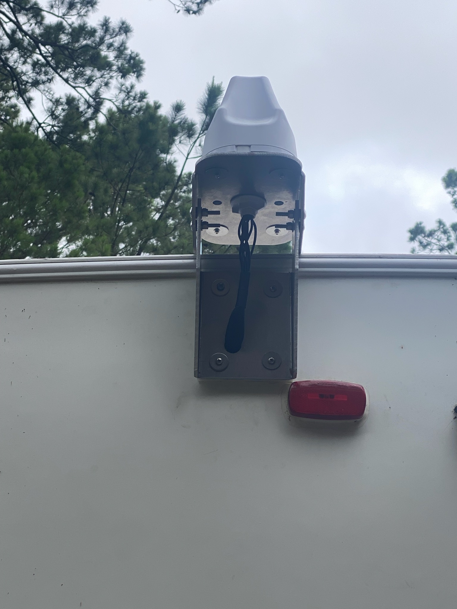

For what it’s worth. Here are some pictures of an antennae mount we made for my son’s travel trailer. Not to keen on making holes in the roof.
At any rate, he was with a group of other campers at a RV park in Ft. Lauderdale. He managed his Starlink through a Peplink CAT-18 and allowed campers in his group to access his network via WiFi. A few were in excess of 300’ away. Multiple streaming applications were active at times.
I would like to think this success could be attributed to the design of my mount (HA HA)… in reality Peplink, Starlink & Poynting made it possible. Peplink was mounted in a cabinet in the back of the travel trailer to minimize antenna cable run. Distribution of signals from DISHY to Peplink was wireless with the DISHY fracas installed in a storage bay in the front of the travel trailer.676748758.jpg|1536x2048
