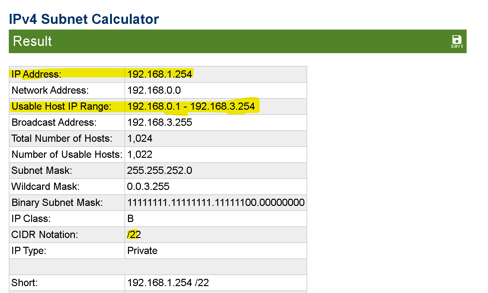

On a calculator I saw that I have to set the IPs =
192.168.0.1 - 192.168.3.254

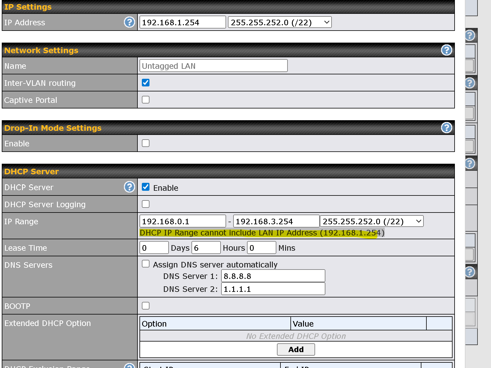

If I do it I get the error:
“DHCP IP Range cannot include LAN IP Address (192.168.1.254)”
I understand the error. DHCP can’t contain the ip 192.168.1.254

The Balance LAN IP address must be outside the DHCP address range. If the 192.168.1.1–254 range is reserved for static IPs, then you could use a DHCP range such as 192.168.2.1–192.168.4.254 (/21 subnet).
Alternatively, you can create a separate subnet using a VLAN only for Wi-Fi clients.

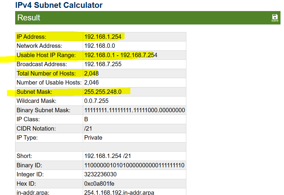

It seems incredible to me that to use DHCP with that number of clients I have to switch to /21! It is very clear to me anyway! I am looking at the calculator, I would still have space for more IPs!:

The error is because your router’s IP will lie in the new DHCP range. You need to change it. I.e. set router IP to 192.168.0.1, DHCP range to 192.168.0.2-192.168.3.254. or router IP to 192.168.3.254, DHCP range to 192.168.0.1-192.168.3.253.
thanks for the answer, unfortunately I can’t change the router’s IP, otherwise I would have to change all the parameters of the PCs with static IP! I’m fine with the answer from @Saulius_Saltmeris
