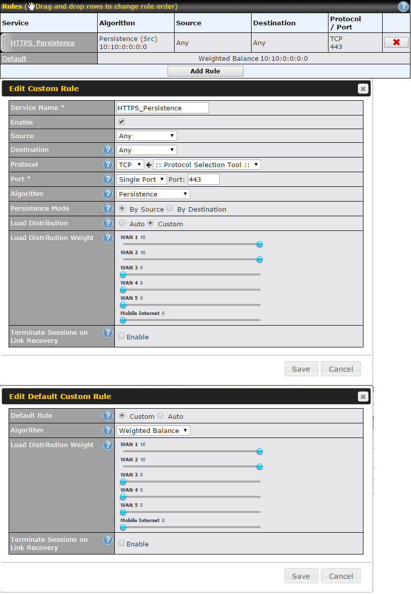

Hi Hootan,
Please find the screen shot below. We only can achieve this at the moment. I assume all WANs are same priority.
