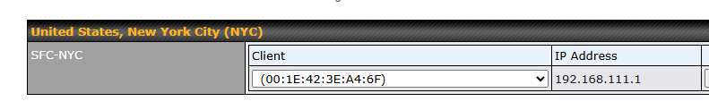

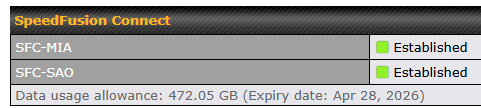

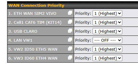

Can you check how you select the wan for your SFC, sample below:
How you select a SFC, using LAN option? sample below:

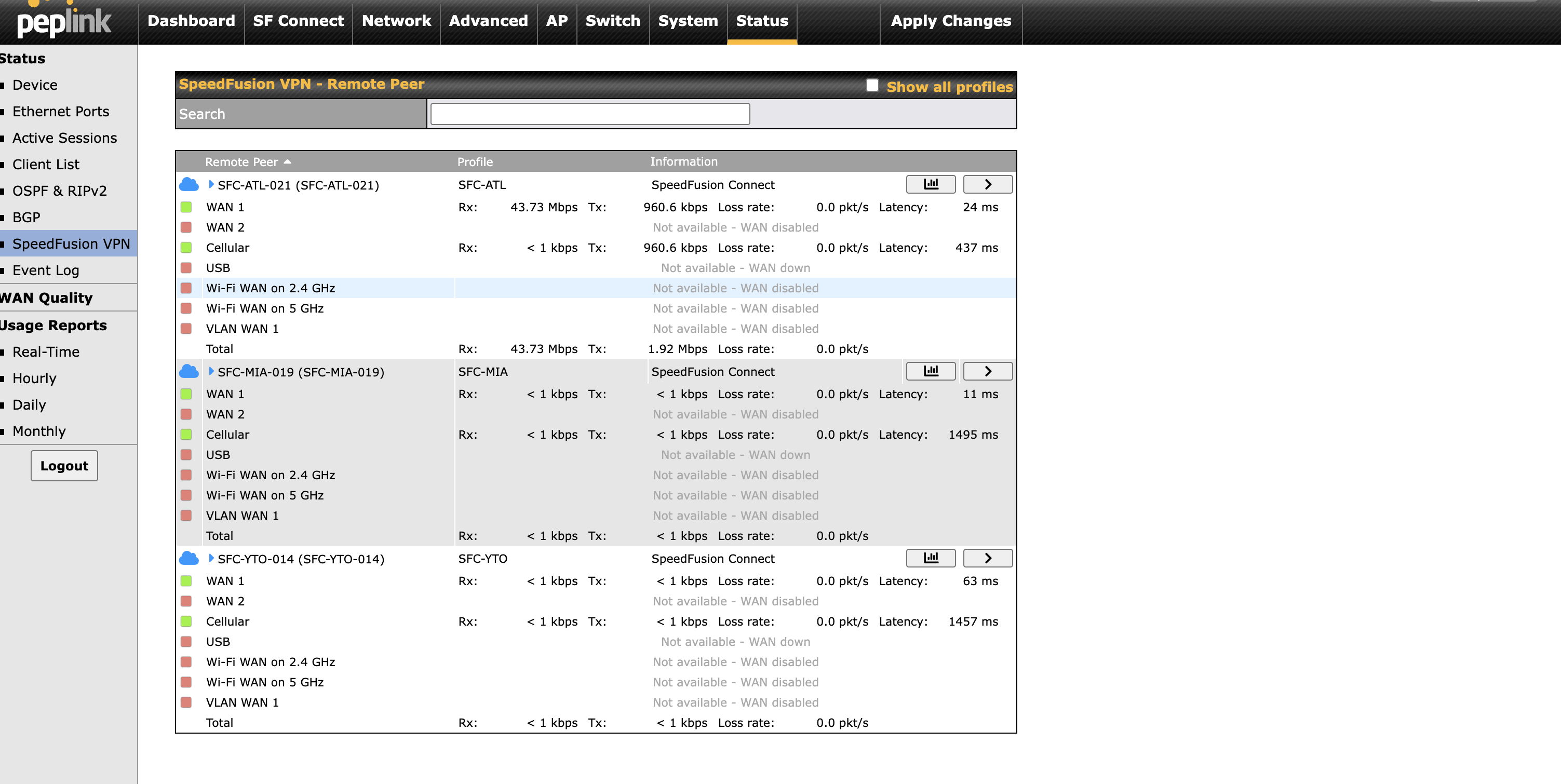

and… check at status… the SpeedFusion connection
Hi. I tried to upload the same photo on my peplink that you showed me. You helped me because when I brought up the SpeedFusion detail I discovered that there was a problem with my outbound policy. I switched the setting for each tunnel to enforced.
Now I am getting seamless failover when I just tested disconnecting my WAN 1 and running over cellular. I got a successful hot failover result 3 times in a row and very satisfied.
