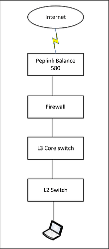

When you perform the speedtest, please make sure the test device is plugged directly into the Peplink router, additional switches and/or hubs can result in unexpected results.
The following diagram will not provide an accurate speedtest result, because it is possible that 3rd party devices are the bottleneck; slowing down the speedtest.
If there are devices along the way, please bypass all the 3rd party devices and connect directly to Peplink router and perform the speedtest again
If you connect directly to Peplink router and still do not able to get the expected bandwidth, proceed to Step 3c
