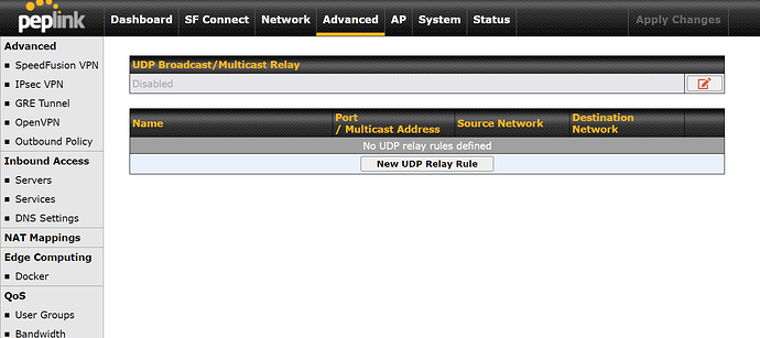

Hello, yesterday I tried several connection options in the lab.
I first tried to activate multicast on BALANCE1350 and HD4 in layer 2 and I was able to activate the transmission only after I changed UDP Relay to Enable in the settings because the default was initially Disabled.
I tried to switch to working with FusionHub with HD4 in layer 2 but Multicast did not work.
I checked the HD4 Udp Relay and it was enabled.
When I tried to find this option in FusionHub and I couldn’t.
Does anyone know how to activate the Multicast (udp relay) option in the FusionHub virtual machine?
