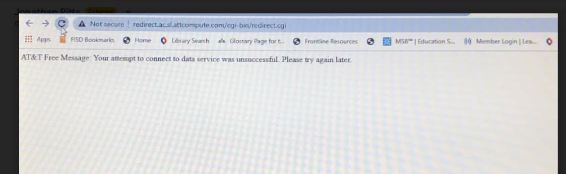

It just happened again, this time the message is: “AT&T Free Message: Your attempt to connect to data service was unsuccessful. Please try again later.” - I did my switch to Verizon and straight back to AT&T and got back on the network.

One of our value partner @Jonathan_Pitts , given me the following screenshot, the message shown that the proxy for the AT&T network redirected the access.

Do you get that werid redirect page that I did?

Yes, it still shows that I’m connected to AT&T LTE, if I have my VPN up it tells me that my network provider is restricting access and when I open a browser I just get that redirect page, the exact one you get.
If you get that exact redirect page, then it’s something ATT is doing…

I think the walled off area is a reasonable assumption, DNS appears to work but otherwise data can only go to Page was redirected. where n is whatever error condition they’ve detected during login. I took a look at msg=1, 2, 3 and so on, and they’re all about account problems, for example msg=6 is “It looks like you want to use data but have none available.” So this does seem account related, or authentication related.
Can you post your error page? What was your msg number?
