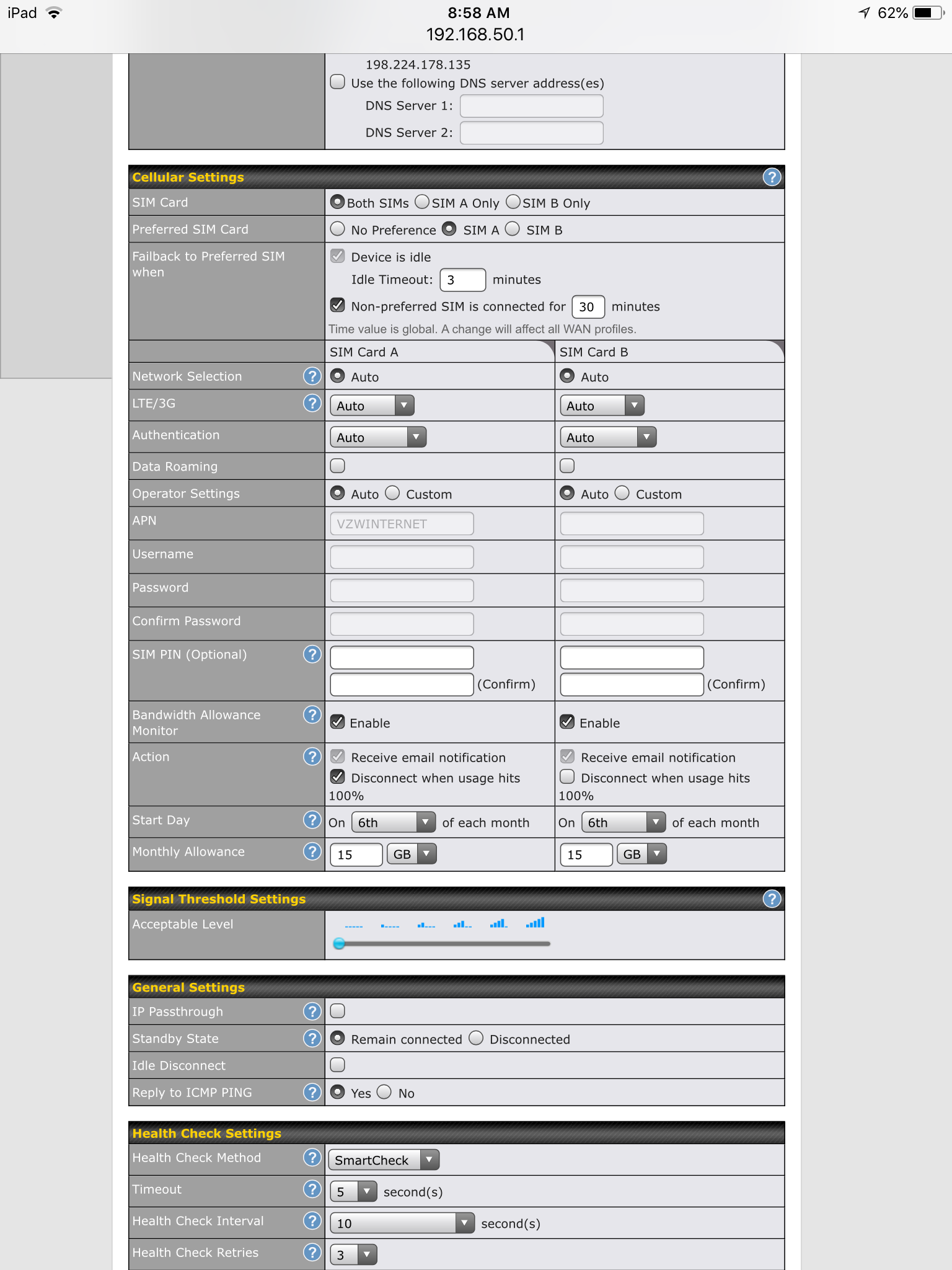

This is my current settings.
Please advise.

Steve this is copy of new settings. If it looks good let me know. Or if change needed advise.
Thanks Steve.
Yep, that looks good to me :slight_smile:
Steve
