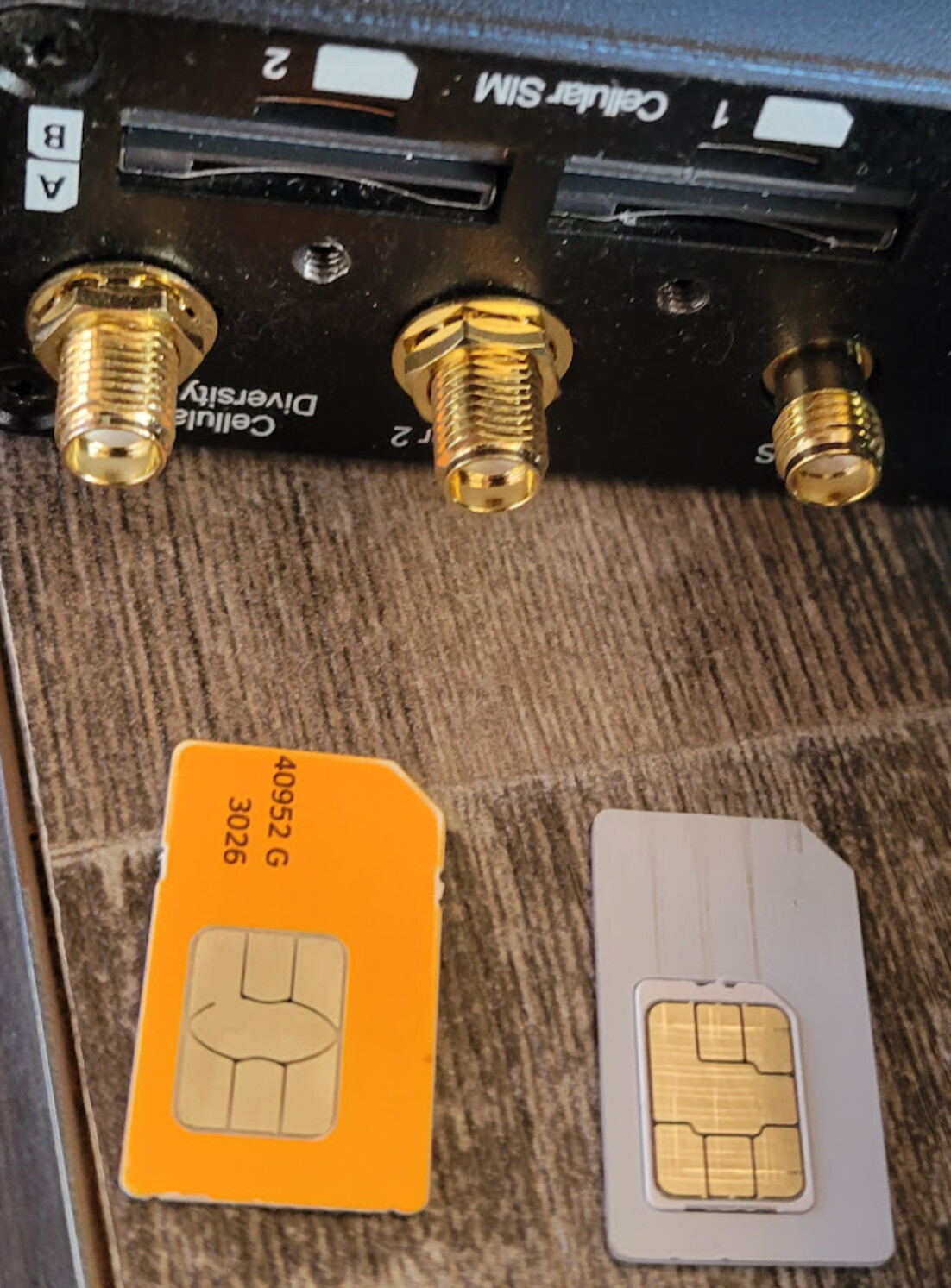

RE: FCC Case #00026860 | [Peplink #22020882] SIM Card connectivity [ ref:_00D6A2zSvx._5003uoPrRE:ref ] Re max transit duo BF2D: AT&T Sim works perfect. Google Fi worked fine with previous account and now just stuck trying to obtain IP address. Firmware is current. Confirmed that SIM slots and different antenna connections all work. I’m convinced that this is not a hardware issue. Suggested APN (h2g2) and DNS settings (8.8.8.8 8.8.4.4) were tried and did not work. Shows IMSI (in use) and carrier as Google Fi. I am currently in a good known spot for connectivity (5 bars AT&T/ 4 bars Google Fi plus actual tests confirm both cellular transmissions are solid.) Google customer support has not been helpful. Thanks in advance for help anyone may have to offer. markb
Is it getting an ip address?
What color is the sim white or yellow?
