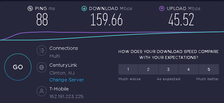

The issue Im having is max download speed. Im using www.speedtest.net from both my HP laptop and Samsung Galaxy S20 Ultra 5G to test download speeds through the Max Transit 5G. When I connect my laptop or S20 5G to the Max Transit5G’s WiFi, I only get between 101-130 Mbps download speed from both devices. I also tested DL speeds from my laptop connected directly to the LAN port on the Max Transit 5G and WiFi disabled on my laptop. Sam results, 101-130 Mbps…

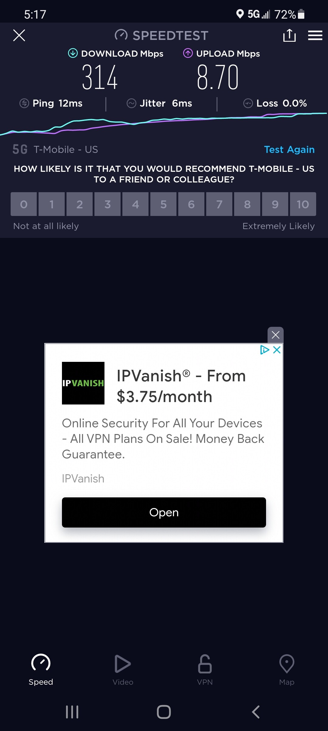

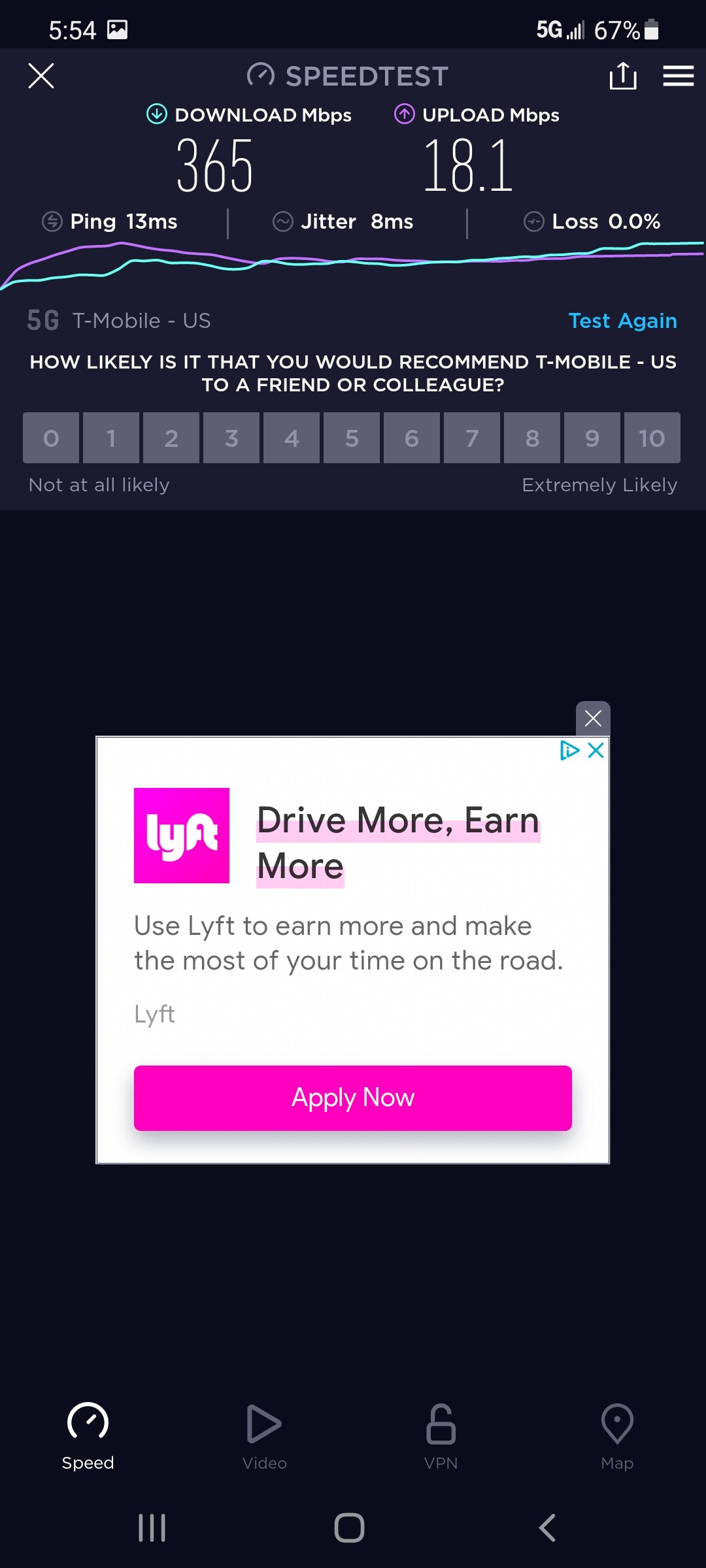

But, sitting right next to the Max Transit 5G, running the exact same www.speedtest.net, selecting the exact same Speedtest Server (School District of Philadelphia), from my Samsung Galaxy S20 Ultra 5G on 5G cellular only (WiFi disabled) and my phone showing 5G in the top right corner… My phone gets 335-355 Mbps download speed.
Trying to find out why my Samsung Galaxy S20 Ultra 5G gets consistent 325-365Mbps 5G download speeds and the Max Transit 5G, same cell carrier, gets 1/3rd the download speed, all else being equal.

Just another data point for you. I have a Max Transit Cat 18 and no matter how many bands I’m connected to, I max out at 160 as well (130 if I have remote assistance enabled). I’ve always thought… the device is rated for 400Mbps… combine that with the features I have enabled… I think the real world max throughput is 160. The CPU goes to 100% as my device approaches 160, so to me it appears to be a CPU horsepower issue. Might want to look at your CPU on the peplink when your connection is maxed out.

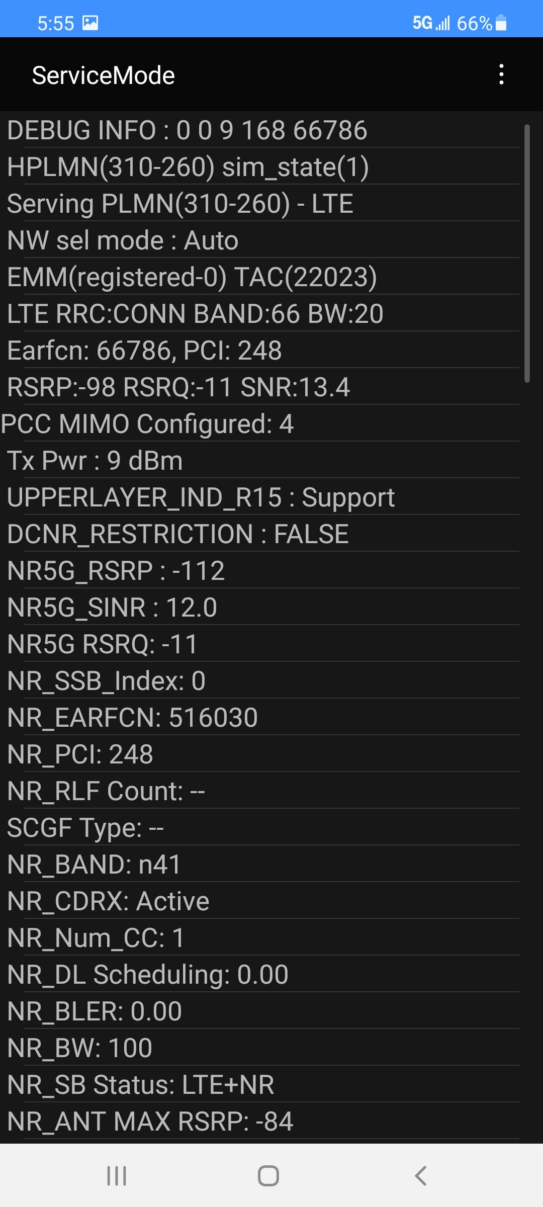

Both devices are connected to 5G NSA 3500MHz with -100dbm RSRP - it looks like the CPU is limiting here as well.
