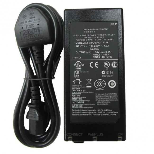

Hi @jonault,
Could it be that you’re looking for the PoE injector?
The part number for this is ACW-107.
Hi @jonault,
As stated on the Peplink website, the Pepwave MAX HD2 LTE IP67 supports 802.3at PoE input.
See: https://www.peplink.com/products/max-cellular-router/outdoor/
The PoE injector is available separately, part number is ACW-107.
If you would like to use a DC cable, you might be better off getting one from a local electronics store.

Hello @jonault,
We never have used the DC power option for any customers yet, we have always used a switch or PoE injector at the customers location to power over the Ethernet cable, two units for doing this that we are having good results with are:
These are solutions that are working for us and if you are in a bind, like what @Joey_van_der_Gaag said, these are options to help get you reconnected, use them as a guide with choosing alternatives from your local supplier.
