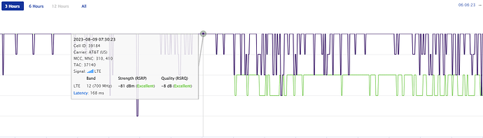

Here’s an example of what we’re seeing daily many devices.
Device is on band-12 700MHZ at -81 RSRP and then switches to band-2 1900MHZ at -102 RSRP
Maybe it’s because the 1900MHZ had better latency?

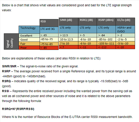

Hi Rick, It’s not in the excellent range but according to your chart -90 RSRP is top of the good range.
Below is the chart we’ve always referred to.
Right. My assumption when you referred to “signal” you were talking about RSSI – which is not good at all. If, in fact, you refer to RSRP, I’d say it’s “OK.” And, yes, your table is fine – there are a zillion of these floating around the internet and they generally pretty much agree. But regardless, I’d want to know more about the SINR. We have seen oh-so-many cases where RSSI and RSRP were nice but SINR was crap. In such cases guess how the units performed … ;<)

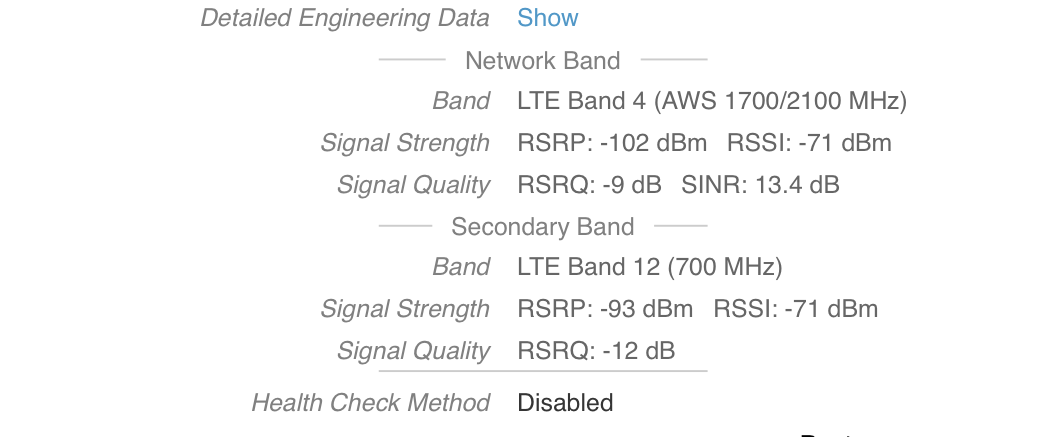

  1. SINR is reported in IC2 in the same place as the other engineering data for a cellular connection. Here’s a screenshot for a BR1 Mini LTE-A (CAT-6):
    In my experience it varies w.r.t. whether SINR is reported across all the bands selected or only the primary one.
  2. Communication quality v. signal quality may be correlated, but it may not carry from one band to another. E.g., in one of our locations Band 12 looks really good and Band 4 looks really bad, and yet connections using Band 4 are much better in practice than those using Band 12.
  3. My understanding is that the service provider ultimately decides which bands to employ: The modem offers up a menu of bands (that’s what you can determine on the Peplink router), then the provider decides which of these to employ for a particular connection.

Thanks for confirming that SINR is still displayed in IC2
After seeing this I dug deeper and appears that SINR isn’t displayed for our devices with the Telit LE910-NA V2 modem which if you saw my other post appears to be the common denominator with our Pepwave devices randomly going offline and needing to be rebooted. Checked devices with both ATT and Verizon as the carrier.
