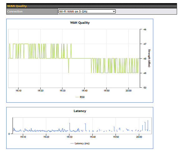

I could use some help trying to troubleshoot a problem I’ve been having with the 5 GHz WiFi and client disconnects. I had opened a ticket about this problem and after several months of back and forth and remote assistance I was able to get a replacement unit that is showing the same problem.
Client devices that connect with 5 GHz will become disassociated and unable to reconnect for intermittent periods. When using the WiFi as WAN the 2.4 GHz band works solid but the 5 GHz band shows the intermittent drop outs/disconnects in the Latency graph on WAN Quality Status page even though the RSSI is steady at around -48 dBm.
The MAX is in an RV currently about 12’ away from the AP it’s connected to and in the attached screenshot I have the Health Check pinging the AP and the MAX is the only client.
I’ve tried different channels and locations to try and eliminate RF interference as a possibility but nothing has helped and now at a loss.

Thanks for sharing your experience with your max…it looks to be very close to what I’m seeing. To answer your questions:
  1. Currently using firmware 8.5.2 build 5862. They had sent me a newer version which didn’t help on the old max but haven’t tried it on this replacement.
  2. I have not tried to track the clients to the drop outs with the WiFi as WAN but based on what I’ve seen with the frequency of the client disconnects they probably do match up. These dropouts are much more frequent from what you describe with disconnects on mine happening every few minutes with random periods of time between the dropouts.
At this point since the 5GHz band is all but useless, I’m only using 2.4GHz.
