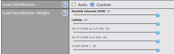

So just to expand on the current issue. Whenever I set the priority to backup on any WAN connection and in any backup position other than priority 1 it holds that for maybe one second and then immediately jumps back into priority 1 (see screenshot). Dragging the connections down to a lower position does the same thing where it jumps back into priority 1.

Hi the problem is in these settings, you have it on persistence
You should change it to priority otherwise cellular will be online as you have divided the loads on all connections.
