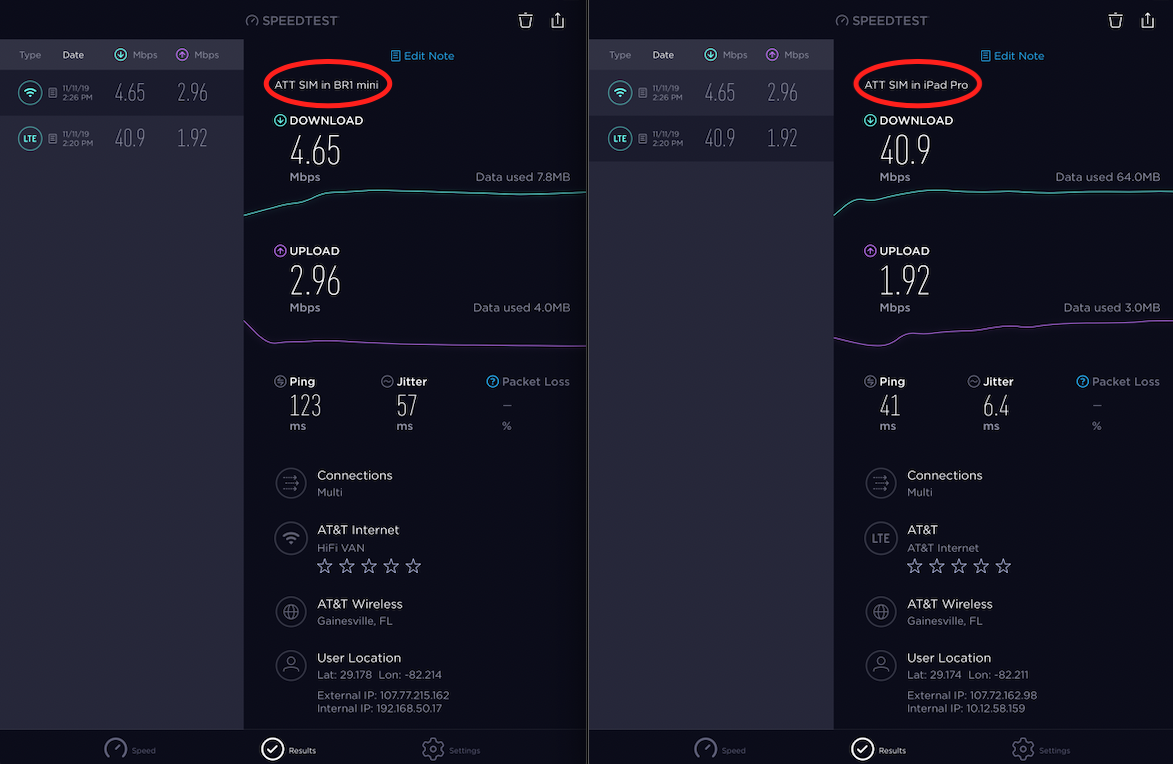

As for the LTE data through the BR1. Here’s a screenshot of two speed tests. The same SIM card and location, one with the SIM card in an iPad Pro and the other in the BR1 over WiFi.
55%20PM|690x449

Is this a BR1 Mini LTE or LTEA? I think the iPad Pro has “Gigabit‑class LTE connectivity” which sounds like LTEA.
LTE in the lab gets 100Mbps download (CAT4 radios) and LTEA gets 300Mbps on CAT6.
So you may find you’ve got faster radios in the iPad than the BR1 Mini?

But the LTE is still SO slow. I even tried a friend’s cheaper MoFi device and it showed 55mpbs download while it was getting 4-5mbps with the MAX BR1 mini. I just don’t get it. All testing parameters where the same, the only variable was the device used.
