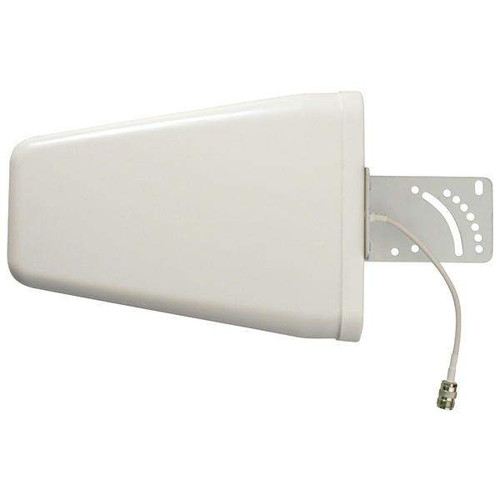

I do have two atennas available to work with. A omnidirection wilson RV / Trucker antenna and a Directional wislon yagi antenna

Antennas on BR1: So far as I know (and I’ll be pleased to be corrected on this), the Mini transmits using only one antenna. The 2nd one is used for diversity receive/MIMO. If you use a directional antenna you may essentially limit yourself to the use of a single site. That’s risky. Suppose, for example, that site loses its back-haul. You’re OTS. This risk is exacerbated because Sprint uses only a single site for CA.

There are antennas available that would likely do what you need to do, but the best ones are not the ones you referenced. PM me if you want to discuss further.

I use Sprint service at hundreds of locations across the US and deal with different issues with each of their bands. There isn’t an amp that I know of that supports band 41. Using directional antennas like Wilson, etc also presents issues. I’d use a pair of 12dbi outdoor rated omnidirectional antennas. I have had great success with them both indoors and out. I can help you obtain them if you’re interested. They are about $100 each.
