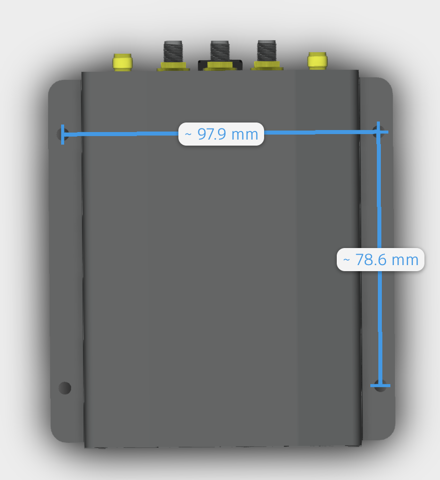

Hi
Looking for the latest demensions for the mounting hole locations on the Max BR1 Mini 4G / 5G / Core - assumming they are the same…
Thx
M
Thanks for the link. I had found that. But it is not for the Mini.
The width dim is 136.8mm → this is a bit wider than the Mini’s overall dimension.
Sorry about that! Here is a correct diagram:
