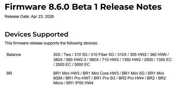

Looking at the Release Notes of the new BETA version 8.6.0…
There is nothing about hw1, hw2 and hw3 for mini5g.
