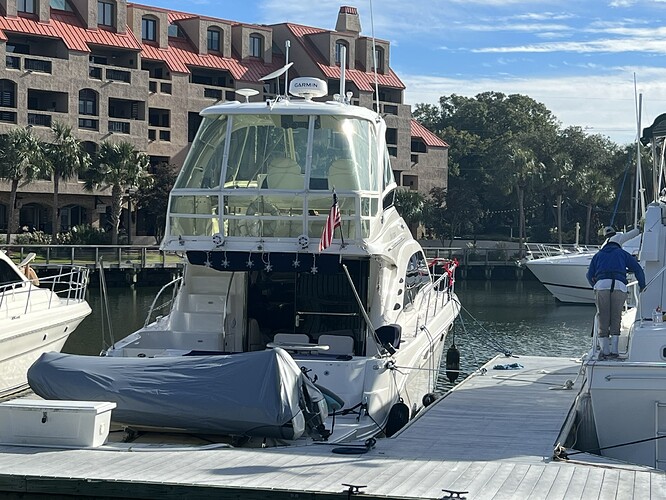

The 40G is on the Roof, see photo. All test were performed without any other of the electronics running e.g., Radar, VHF, starlink, etc.
Thanks for the photo. Even though the other antennas are not active, they are fairly close to the 40G - especially the VHF antenna - and the vertical metal elements may be causing multi-path interference. The radar, even though it is off, also has the potential to block the signal since its elements are very close to the bottom third of the 40G as well.
Also the 15’ extension with the 6.5 feet of existing cable is right on the border of being too long (cable length loss will overcome gain from the antenna).
