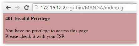

so I did succeed in accessing the modems, but not on WAN2 (I haven’t tried WAN 1 yet). The following occurs:
  1. Go to 172.16.12.2 in browser –> official login of modem –> no problem
  2. fill in the username/password get this
You see that the URL is now incorporate with the Peplink /cgi-bin/MANGA. And my modem is not using such cgi-bin, for WAN3 it shows this:
Any ideas? (is there a difference/bug in WAN1&2 vs LAN1/2/3 that becomes WAN 3/4/5?)

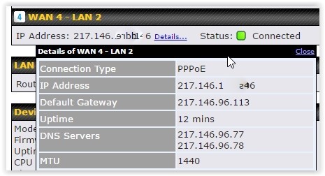

Also odd, I see this in the dashboard (some inconsistency, WAN 3 has ADDITIONAL IP ADDRESS, I fill in the same settings?)
This is strange. You have configured Additional IP instead of Management IP on WAN3 based on the screenshot. Can you provide the screenshot of the settings of WAN2, WAN3 and WAN4 (Network > WAN)?
Well… sorry about that. I see where the additional IP comes from. (I added under
Additional Public IP Settings)
Sorry, but WAN2 still doesn’t work.

Hello,
Actually, since I removed the ip address in WAN 3 - Additional Public IP Settings, WAN2 allows me to login now.
so I tried the following:
  1. removed 172.16.13.2 to WAN3 as additional Public IP address
  2. WAN2, 172.16.12.2 works, no more 401 issues
  3. add 172.16.13.2 to WAN3 as additional Public IP address
  4. login into 172.16.12.2 (WAN2) –> no more 401 issues
  5. login into 172.16.13.2 –> peplink login, which should be correct setting after step 3
  6. removed 172.16.13.2 to WAN3 as additional Public IP address
  7. This screens appears now on 172.16.13.2
so I think I now know how to replicate the issue, does this looks like a ‘software’ issue?
